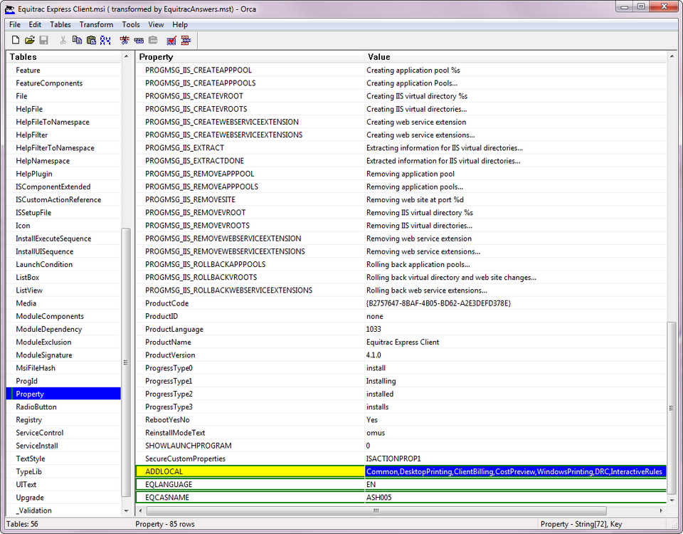

mavhc I tried to create a MST and found the EQCASNAME & EQLANGUAGE property in orca so added these fields and the program installs. However I don't now how to select the features. I found a feature table but can not find a ADDLOCAL property and if I did would I have to add multiple ADDLOCAL rows for each feature or could I add them like I'm tried to in the above. Please see attached and hopefully it makes sense, if you have done this before and can help I would be eternally greatful

That looks to be the right way to go about it, add your own rows with exactly the same format as the command line, ignoring the quotes of course
Everything looks fine in your screenshot (although technically you are not meant to put the ADDLOCAL property in an MSI or MST). If you use the command below, does it install successfully?
msiexec /i "Equitrac Express Client.msi" TRANSFORMS="EquitracAnswers.mst" /qb!
Edited by Arthur

Right guys Arthur is defo right the ADDLOCAL, it will not work in the property section which if you read the link it makes sense. It is a shame because the server name and language in the MST works a treat :( I have change the script to look like what shinobi suggested and added the /q so it works silent. Ended up with this:
@FatBoy. I have just thought of another way you could do what you want without resorting to using VBScript's. :)
  1. Open your MSI and MST in InstEd or Orca.
  2. Go to the Property table.
  3. Look for the INSTALLEVEL property and make a note of its value.
    http://i.imgur.com/XmG0T.png
  4. Next, go to the Features tab, and for each feature or sub-feature that you don't want to install, set its Level to a number higher then the INSTALLEVEL in the previous step. i.e. 101.
    http://i.imgur.com/ggNns.png
    This prevents the feature from being installed by default and essentially does the same thing as using the ADDLOCAL property to select the features you mentioned in post #11.
  5. Save the MST and then test.
