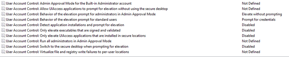

I don't see a UAC prompt due to the GPO settings I use, however if I disable UAC by changing the HKEY_LOCAL_MACHINE\Software\Microsoft\Windows\CurrentVersion\policies\system\EnableLUA regkey to 0 the update will run fine. My GPO UAC settings are With debug mode on I get the following error when attempting to run the software update (SoftwareUpdater being the account with local administrator privileges that I have told 4Matrix to run all updates as) Logging in as the SoftwareUpdater account on the computer and running 4Matrix results in the update running successfully.
I'm getting the exact same problem as you Garacesh, I thought I was going mad so i'm kind of glad it's not just me having this issue! If I turn off UAC then the update will run perfectly fine but with UAC on and a local admin user account set to run the updates in the settings file I can't make it go through as a normal user. Very interested to find out the answer to this one.
