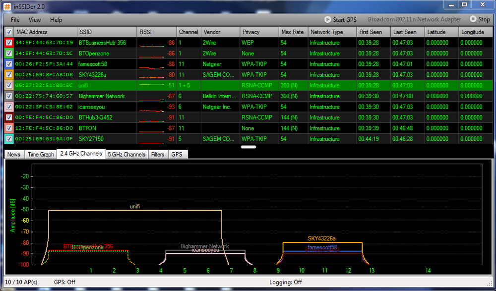

I wont waste time repeating what has been said elsewhere, I would suggest some more study, IEEE 802.11n-2009 - Wikipedia, the free encyclopedia and 802.11n Speed - How Can I Get an 802.11n Wi-Fi Speed Rating of 300 Mbps?
The great N debate goes on and if you care to take a look at a 2.4Ghz 40Mhz N AP with spectrum analyser such as ssider you will see what is meant.
(I run my home Unifi N point at 40Mhz just to hack the neighbours off, I swamp the street with Max power hidden SSID at 40Mhz consuming Channels 1-7)
