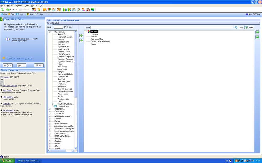

Attached image of how I've a report set up which seems to do what your after.
Bascially, from the student details under Conduct, there's an option which is Total Achievement Points which seems to be automatically filtered on the current academic year.
Not sure, I didnt change anything to get it to take the data from there.
