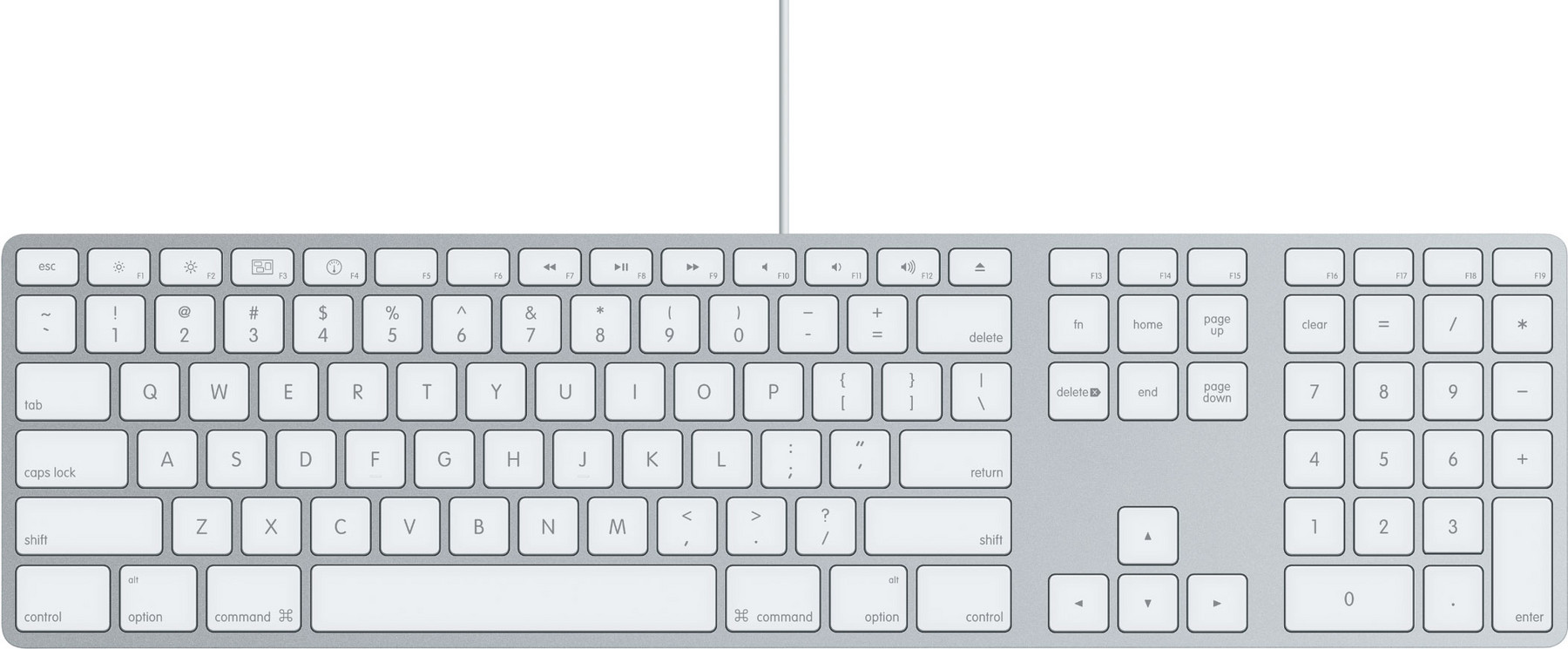

Thanks Dan,
Apart from the P & R keys I'm not sure which the keys you are on about are - our Keyboard doesn't have anything marked CMD or OPT?

Thanks for that. Should be able to work it out now!!

[ATTACH=CONFIG]11131[/ATTACH]
or can you find and post a pic of the keyboard you have ??
bottom left or right normally opt is option and command or cmd ?
