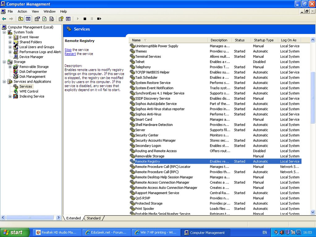

speckytecky Posted November 17, 2010 Report Posted November 17, 2010 Anything to do with the remote Registry Service I wonder - we just started to get some Windows 7 OS PC's I disabled it on them and that seemed to fix the problem for us.
eddyc Posted November 17, 2010 Report Posted November 17, 2010 Anything to do with the remote Registry Service I wonder - we just started to get some Windows 7 OS PC's I disabled it on them and that seemed to fix the problem for us. [ATTACH=CONFIG]8592[/ATTACH] Just checked that one and it's already disable on our image
