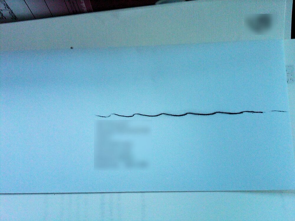

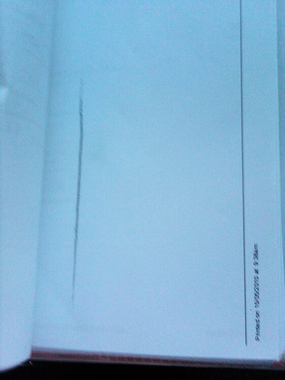

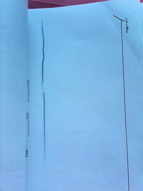

I have a HP 3005 that's produces erratic smudges. I've done all the cleaning of rollers I can do, so am at the point of getting someone in to repair it but was hoping for a second opinion.
Sometimes it goes through dozes of pages without any marks but then lines can be produced as on the attached images. The printer is mostly used for printing letters for parents and on occasion on envelopers which is where I think the problem may come from. I'm told though that the smudging comes and goes without having done any more envelopes.

There is only one line, and it's central on the page. Sorry should have confirmed the line on the right-side is correctly printed and not a problem.
PS Thanks to the mod that fixed my typo in the title :)
Wonder if its the Teflon coating on the fuser roller thats damage, I have a few in classrooms if they get a lot of black pages through they build up toner in worn patches on the fuser roller cover and thus give black smeers / patches etc but they can be patchy at times.
