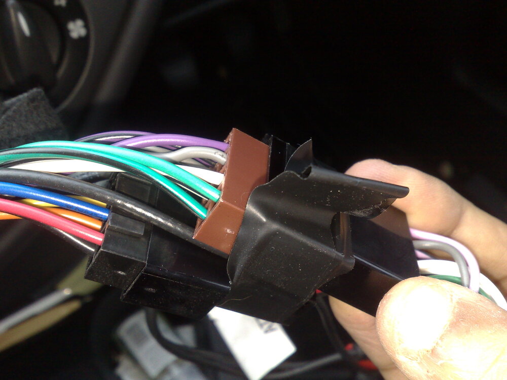

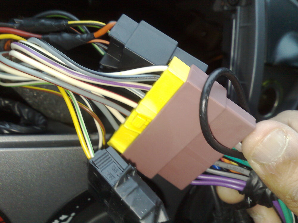

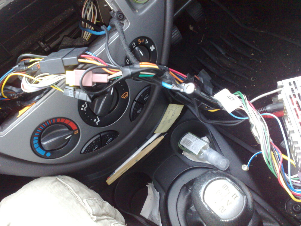

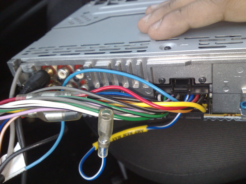

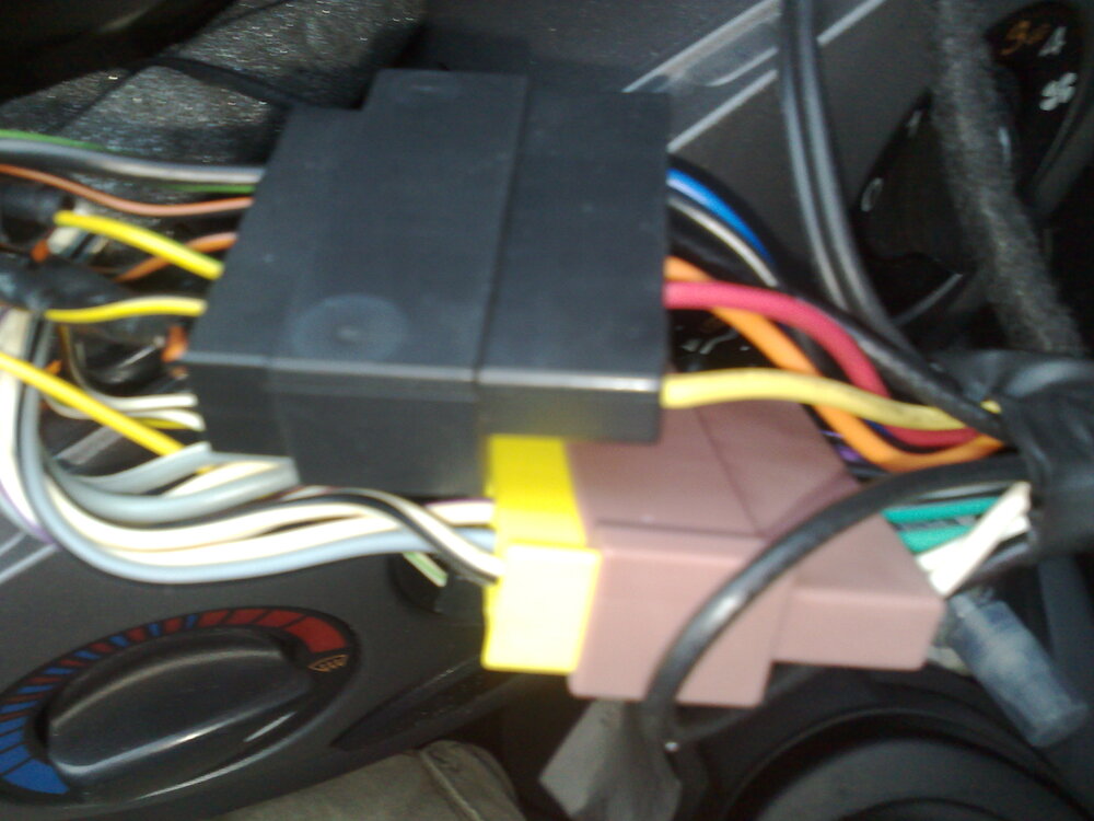

Previously i had a focus (earlier model) which I purchased an aftermarket radio for which was a Sony DAB6650 radio, i now want to take this out my old car and move it into my new Focus (newer model).
I pulled out the stereo from the old focus and was shocked with all the cables..... there were so many! I left it in there because I thought I would never be able to reconnect this into the new focus. The additional difficulty is the aftermarket stereo has a dab aerial which I will need to remove also.
I believe I would need to buy a new face plate to suit the new focus shape, do I need to buy different cables or would the cables from the old focus work? Sorry I dont know what the correct names for the cables are.
I attach some pictures to hopefully help.

I only know about Mondeos but they use the same head units so in theory its the same - it's something known as a quad block. If it doesn't fir, Halfrauds will sell you one, and theyll sell you a face plate too.
when its all unplugged the only wires you should have left to plug back into the old stereo are the big fat blue wire (standard areil) and the brown & black plugs in pic 5
everything else should be removed
once it's all removed follow the wires from the stereo back to the first lot of connectors and let me know what plug is there (post up a picky) and we should be able to advise on the cable you need
Cheers
Andy
