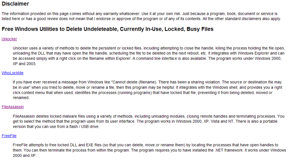

UNLOCKER 1.8.7 BY CEDRICK 'NITCH' COLLOMB
if you went to the link i posted above as per my screen shot attached it mentions unlocker ;)
Not sure if you did or not just thought id mention it
Edited by mac_shinobi
I had already found it actually but it's a good link so i'll send you some thanks over ;)
no problem
the free country website has a lot more links to free software etc if you click on the utilities link at the bottom left it will take you to the relevant page
