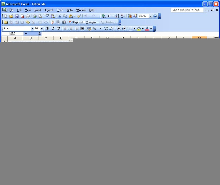

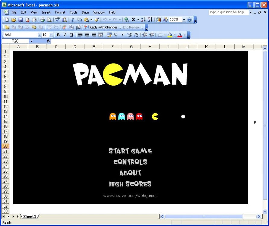

If you think .swf are an issue I found these in excel spreedsheets the other day...
Tetris.xls,pacman.xls,sonic.xls and golf.xls
Smart kids whould have renamed them thought..
