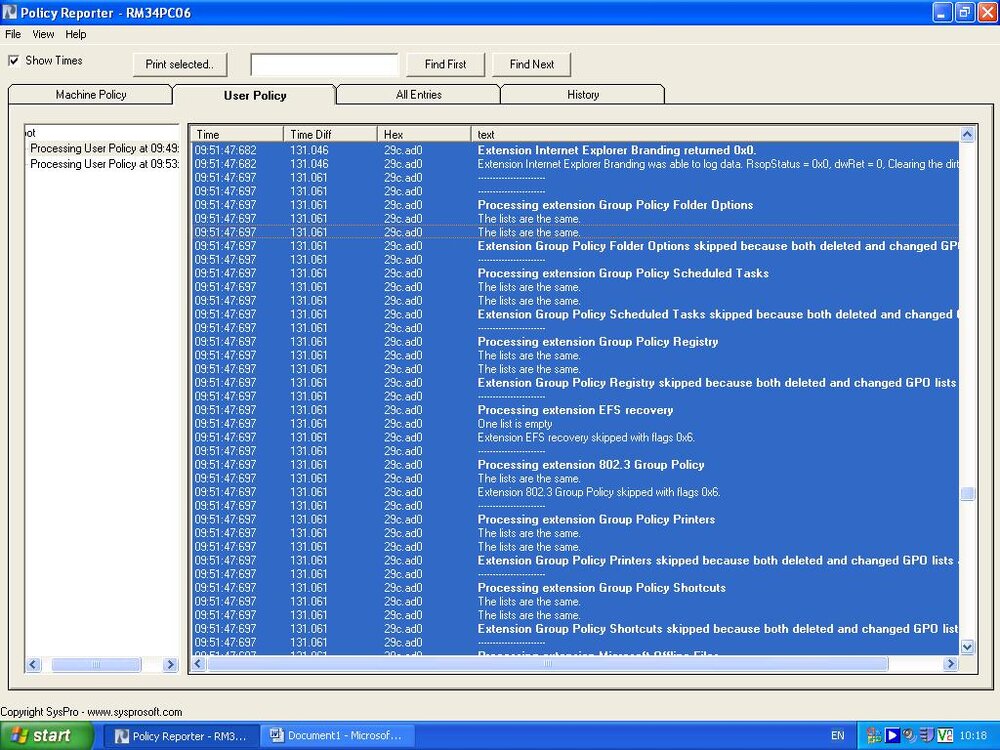

I have used a program called policy reporter and enables the userenv logging and it says its definitely internet explorer branding.
