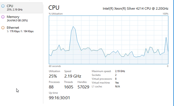

I recently threw a lot of resources at our SIMS server also to stop complaints of performance from a system level so anything from here on in is purely DB indexing:

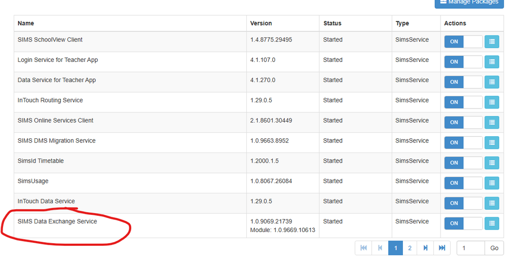

If you're not using SIMS Nextgen disable this one:
I would try this before a reboot, personally.

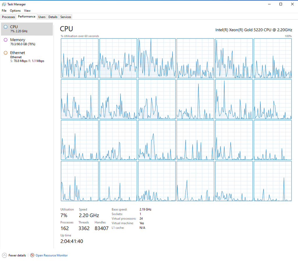

Yeah, our SIMS server was on the same spec as yours and we were seeing high CPU loads about 6 weeks ago so I just went nuts and assigned a ton more CPU proessors as its a VM and we had a fair few to spare.

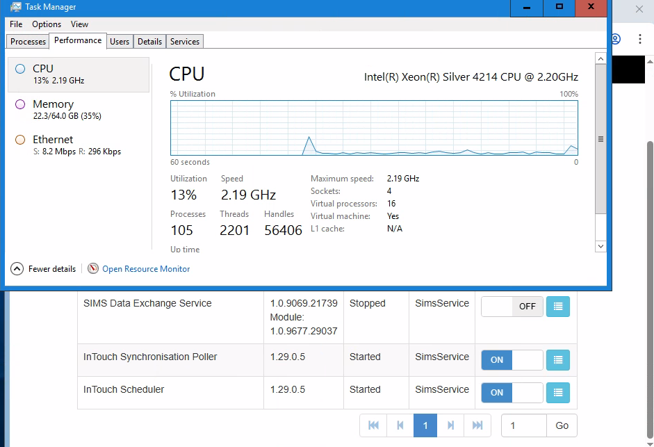

So I can now confirm that the Sims Data Exchange service is the culprit, as soon as I turn it off from SSM, CPU usage drops to 5%. I've done similar as you @Tefters and increased number of CPUs to 16 as had some spare as well and with this DEX service on now it maxes to around 55% so a huge drop from 99%. @SIMS_Customer_Support this needs to be fixed.

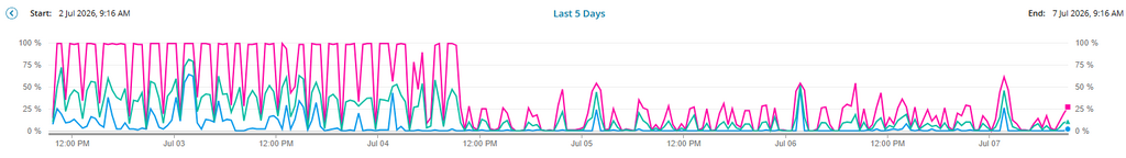

8 minutes ago, fraserr100 said:
I ran the SQL query in this  Troubleshoot change tracking auto cleanup issues - SQL Server | Microsoft Learn under the 'High CPU utilisation during clean up' section on Saturday and it made a huge difference. See below.
