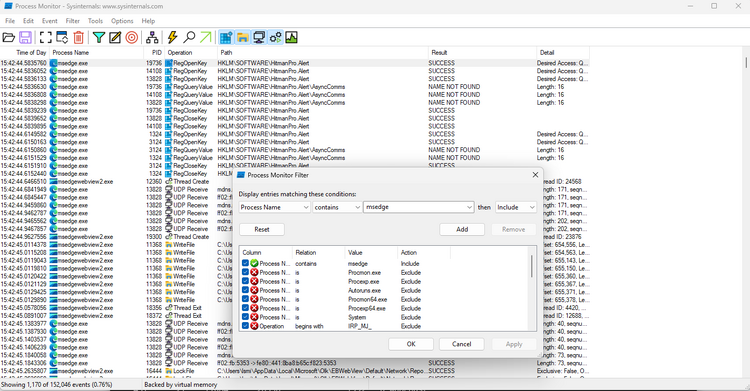

Any luck with Procmon? If you filter the process name you should be able to see what it is trying to do
I had a quick look, it was the first time using it and maybe I need to invest some more time into it.
