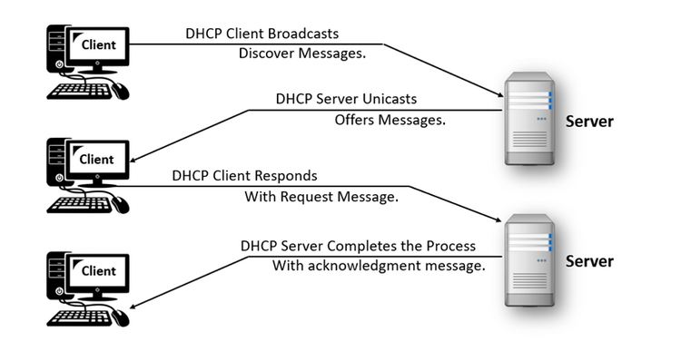

Alastairb25 Posted September 5, 2025 Author Report Posted September 5, 2025 Its more like Client has an Offer from DHCP server but fails to send a Request back, then starts on Discover again
Davit2005 Posted September 5, 2025 Report Posted September 5, 2025 (edited) We had this issue a few years back, clients would discover, get the offer but fail at request. Weirdly when we moved the switch to another module on the HP core it resolved the issue. It is not the first time I've seen a fault with a switch cause a DHCP issue though and the other case was a single dumb switch, the only switch in the network. I've also seen issues with switches that presented them selves as clients not been able to get to an SMB share. Edited September 5, 2025 by Davit2005
