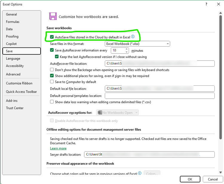

sraper Posted July 18, 2025 Posted July 18, 2025 (edited) Odd one. The AutoSave function works fine in Word and is present However open Excel and the option isnt even available - the highlighted entry is completely AWOL (edited to blur some data!) Edited July 18, 2025 by sraper
sraper Posted July 18, 2025 Author Posted July 18, 2025 Meant to say was like this in Office 2021 so uninstalled and then installed Office 2024 - made no difference
itskdog Posted July 18, 2025 Posted July 18, 2025 I think AutoSave in PowerPoint and Excel is only in the M365 versions, not the LTSC versions.
DalekSec Posted July 18, 2025 Posted July 18, 2025 Is it set to xlsx and not the open office equivalent file type?
sraper Posted July 18, 2025 Author Posted July 18, 2025 25 minutes ago, itskdog said: I think AutoSave in PowerPoint and Excel is only in the M365 versions, not the LTSC versions. I am beginning to wonder if this is true. Problem is that I have Office365 on my work computer but the schools we support most only have Office 2021/2024 and have no plans to change licensing over to 365!
sraper Posted July 18, 2025 Author Posted July 18, 2025 24 minutes ago, DalekSec said: Is it set to xlsx and not the open office equivalent file type? Yes it is
