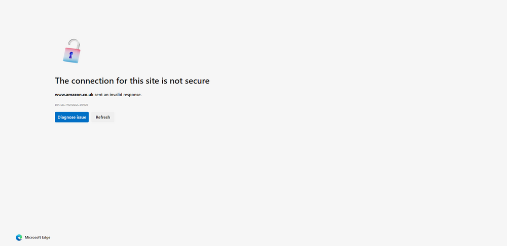

Is anyone else experiencing issues with some websites with Securly filtering? Amazon, Tesco, LinkedIn and a variety of other websites are throwing up SSL errors for us. Issues have been ongoing since Tuesday morning but haven't heard back on my Securly ticket yet.
We do occasionally see these errors, but it's intermittent and hard to troubleshoot. For sites that you're ok with anyone accessing you can add it to your Global Allow list to bypass MITM as a temporary workaround. If you're able to recreate it when using a hotspot to rule out double-filtering, then sharing a HTTP Archive (HAR file) with the support team might help us track down the root cause.

Unfortunately we can't globally unblock Amazon as we have it blocked for students. Plus there are lots of websites that currently don't work and globally unblocking each one isn't viable. Can you get someone to pick up ticket #808294 so we can continue discussing there?

That's interesting as we have DNS as a failsafe too. I have just changed the DNS on my machine and Amazon now works with the extension still enabled. Switch back to Securly DNS and it stops working so definitely an issue with Securly DNS.

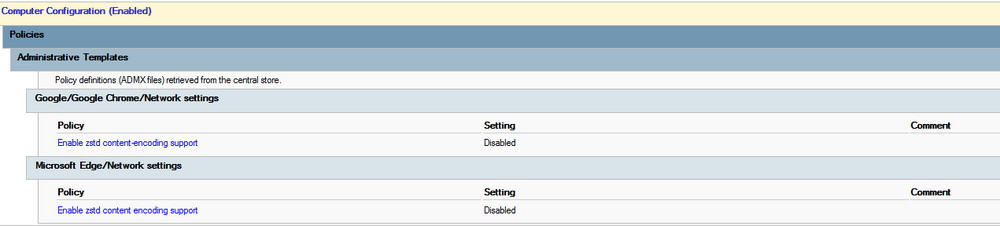

It is to do with ZSTD data compression which can cause problems with both Edge and Chrome - as I discovered with our Fortigate.
I had to download the latest admx files in order to disable the protocol.

I'll look into this ZSTD compression setting - thank you for bringing it up!

On a side note, I just disabled ZSTD in edge://flags/ and it didn't make a difference to this issue.
Bah, I thought we might have a nice root cause there :/

We have just moved to this for our PC stock.  Securly on our Chromebooks has been excellent and so thought it would be the same for our PCs, but no, exactly the same errors as are reported here.  Support keep bouncing back and two while issues seems to be getting worse.  All SSL and all seem related to shopping sites.  Did anyone ever solve?
For us it was an issue on Securly's side and not our implementation. I can't remember what they changed though.
Thanks for reply, its so annoying, works well on our chromebook fleet.  Seems to only be afffecting e-commerce sites bizarly, morrisons, tesco, 1001fonts.com (which is an e-commerce site according to their lists).  Othe sites that use SSL are unaffected and work as expect, so annoying when there is nothing i can do to diagnose or fix really.
