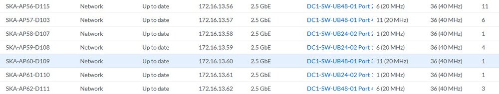

Over the holiday we replaced our ancient Meru WiFi with new UniFi WiFi 7 Access Points, and new UniFi switches.
Although it's generally working there have been a few problems with disconnections, and moving around the building.

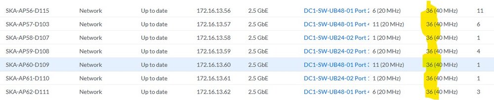

I'm thinking it may be related to the channel selection (which is set to Auto). See screenshot.
Almost all the APs are on the same channel, even those close together. Does the auto channeling just not work? I've tried the 'Optimise Now' button in the settings but that appears to do nothing. I know the channel selection is done at reboot, but even on reboot they come back on the same channel.
Do I need to do the channeling manually?

Having this exact same issue now, seems to fix when i do an Environment Scan on the AP but this results in it restarting so can only do out of hours.
Ideally be good for them all to do a scan every night. Used Ruckus for last 5 years before joining here and i can easily say, i hate UniFi.
Really in my experience Auto doesnt work well. The same thing applies with AP's being set on Auto power as well, if they are fairly close you will need to tune them to get things a bit smoother.

Stick all the 5gh channels on manual. Use 40mhz bonding so you have enough so not to overlap. Example. 36, 44, 52, 60 etc...
Leave 2.4 on Auto. (Print out your site map and write 5gh channel numbers in groups so they are not near each other. Once you're happy config each ap from the controller. Then walk round and test each AP throughput using LANSpeed test. Plus use wifi analyser. This will highlight any issues.
Auto never works in any installation. It's not clever enough and always picks same channels. Especially Unify as its low end cheap kit with poor support.
Just for info Unify also changes the manual channels every now and then. Something it should not do. A restart of the AP reverses the change of channel..
