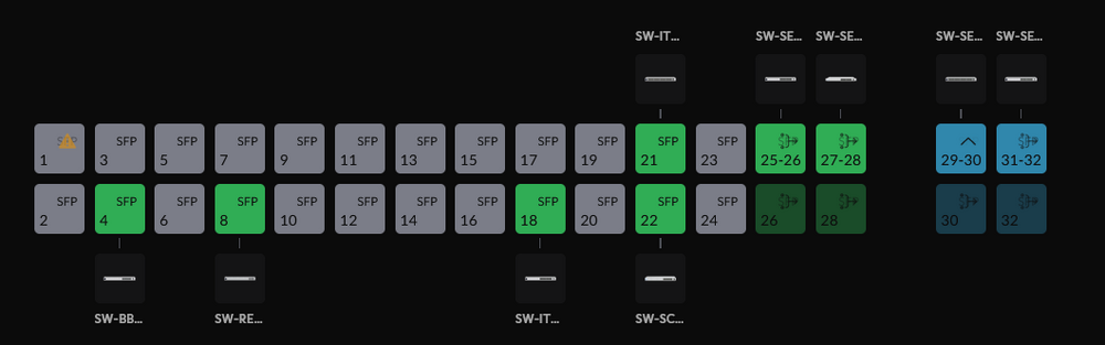

Its a start and unbelievably more speedy than last week.. no ones in though.

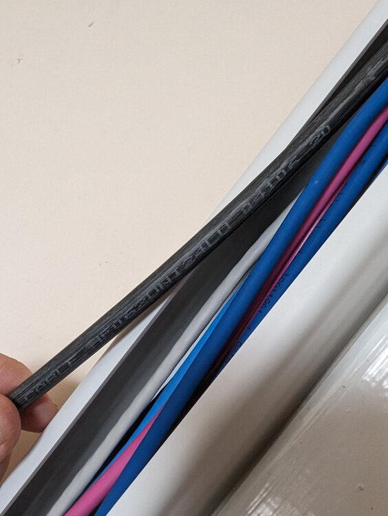

I've found some text on the cable but I imagine its not even OM1.
HF 062 ONI 24LU
[ATTACH=CONFIG]71753[/ATTACH]
I'd assume 062 is 62.5/125 aka OM1, with 24 being the core fibres - That's how a number of them phrase it
