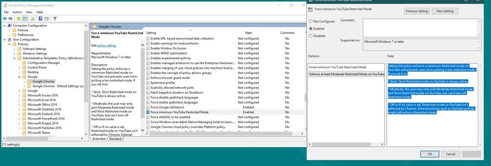

It's more likely to be a Group Policy or other similar managed browser rule that is enforcing safe mode for YouTube.
Yep worth checking. I had similar problem back when we used to use chrome. Previous IT staff had setup the google admin panel for our org & left no documentation, passwords or anything :D
Its either that, or GPO.
