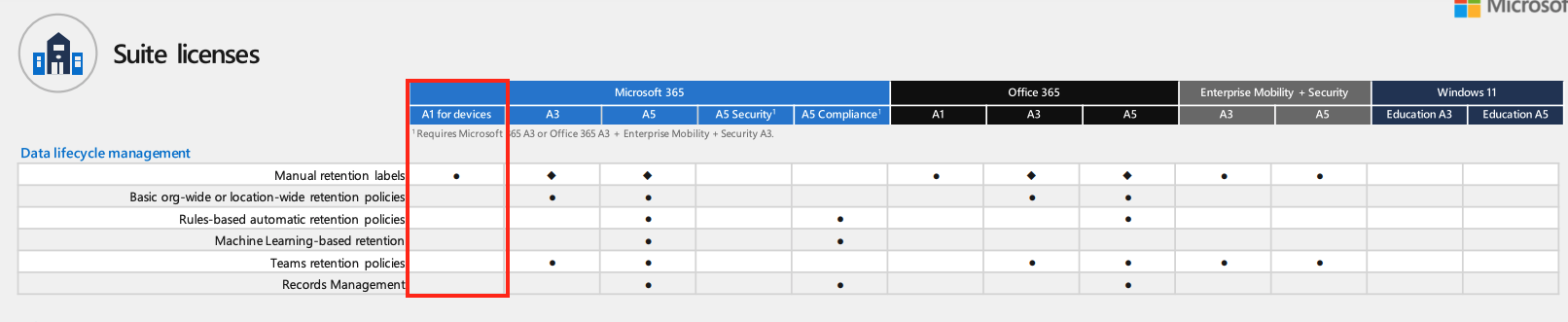

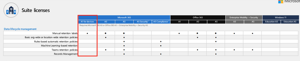

I got the below graphic from our reseller showing what you're allowed on A1 - basically just manual retention labels, which no-one at a school level is going to use.
To be licensed correctly under Microsoft Purview, you'll need A3 for users to set basic retention policies (eg "these mailboxes" = 3 yr retention), and A5 to set retention policies against dynamic groups (eg "security group Staff" = 3 yr retention policy). At least, that is my understanding.
