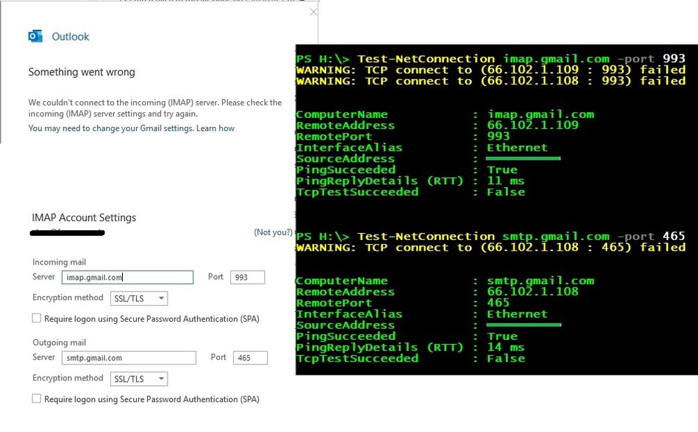

The Outlook message says:
"We couldn't connect to the incoming (IMAP) server. Please check the incoming (IMAP) server settings and try again."
As far as I can see IMAP is enabled in GMail settings in the individual account and globally in Google Workspace admin.
One thing to note is that when I run:
Test-NetConnection imap.gmail.com -port 993
Test-NetConnection smtp.gmail.com -port 587
Both 'ping' OK, but fail on 'TcpTest' ... the fact that it can ping OK means it isn't firewall either, right?! Also the fact that users on their phones can't add the GMail account to Outlook rules out pretty much anything else 'on-site' too?
So it's got to be something in Google Workspage/Gmail stopping anything connecting to it...?

After a couple of weeks spending any spare time I have (not much) working on this, I couldn't get past the fact that it seemed to be a problem with communication between Outlook and the GMail IMAP servers... I ran a few tests in the filtering platform which seems to suggest it wasn't blocked, so I'd almost ruled it out, but...
...just on the off chance I raised a support ticket with LGfL/Atomwide just to casually ask if they know of any reason that I can't get it to connect... I was expecting their usual 'not our problem/we don't support 3rd party software/*sigh* don't you know what you're doing' response....
However, it turns out...
"The problem here is that we've not opened up the Gmail ports - These are done on a per request basis."
Which blows my mind as everyone can access GMail on the web just fine, only it seems to be different accessing it through an application I guess... Anyway, now this has been fixed I'm a bit further along! Well at least to the next error anyway...
Now the IMAP server communication error isn't an issue and I'm guessing Outlook isn't the problem, we are firmly on Google's doorstep!

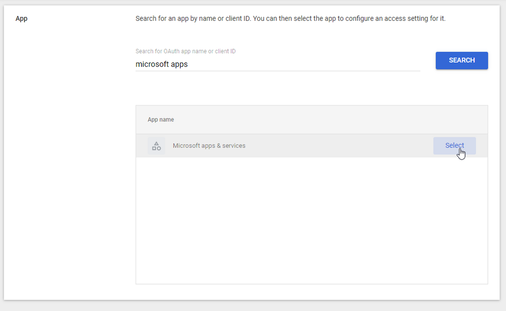

This is what you're talking about when you say Outlook needs to be in some sort of 'allowlist' in the Google Admin console? I'm going round in circles trying to find out where/how I allow it... :mad:
Security ---- API controls ---- App access control
add app
"oauth App Name or Client ID
you should see the client ID in the error you get.

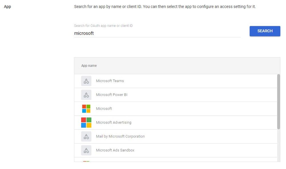

try searching for the name of the app instead of Client Id.
Also think you have to click the text not the arrow for it to drop down........ or is it the other way round :confused:
Believe me, I tried both ways more than a few times...
Searching for Outlook just gives me a few weird and wonderful "we can cnnect an synk yore Outlook, bruv" looking type appz...
Good grief... how can it be this difficult to get an email program to get your emails....?!
It will most likely be microsoft.
That drop down defo not working? cookies, browsing history clearing.... incognito mode? that would give you the client ID to enter.
I think the various Outlook clients will be oauth clients under the name of "Microsoft apps & services". Enter that name to list a bunch of client ids. Which exact one your version of Outlook will be requiring is another matter, but you might feel happy to allowlist the whole lot (that's a decision for you).
Signing in to Outlook 2019 here and "Microsoft apps & services" is the app name shown in my Google account's list of connected third-party apps.
Edited by jthompson
Thanks!
That seems to have nailed it...

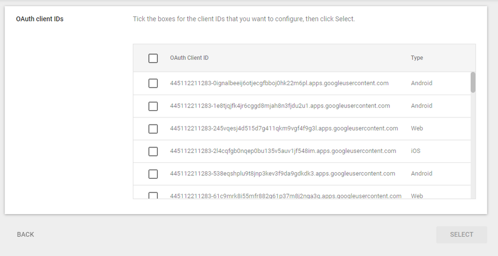

Just interested, did you get the error message @Jaan mentioned or did you 'trust' all the client IDs?
Is 'Trusted' necessary or would 'Limited' be ok?
I've trusted them all for now as working out which ones related to different versions of Outlook/Office would have been too much and I just want everyone off my back...

I've only got 4 of those client IDs trusted. Of those, only two are of type 'web' (which is what it would be, since the other types are Android or iOS).
If you click on an entry there, you can see a user count, which might help you narrow things down.
They would need to be 'Trusted', since my understanding of 'Limited' is that that is just the publicly readable account data (email address, display name, avatar). You'd need Outlook to be getting deep into Gmail data, Contacts, Calendar, Tasks, etc.
