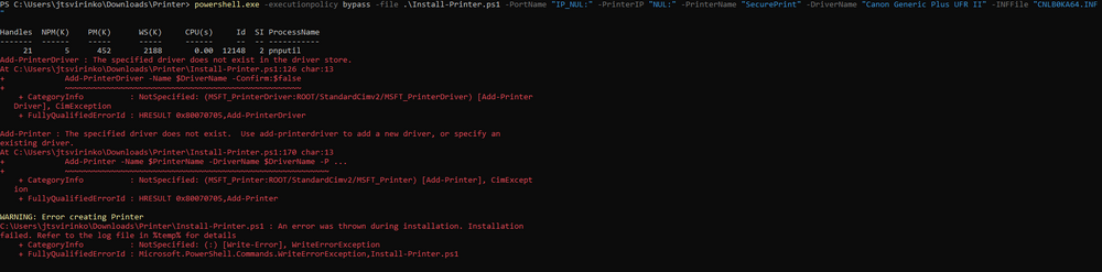

jtsvirinko Posted March 18, 2024 Report Posted March 18, 2024 Thank you for posting this, it is very helpful. I'm running into an issue where the printer is not getting installed successfully so the script fails. I'm deploying to Windows 11 devices and I'm attempting to deploy a queue that doesn't have an IP address and uses a canon driver. Here is the error I'm getting when trying to run the script manually on the device:
Reverend_Dan Posted March 19, 2024 Report Posted March 19, 2024 Are you runing uniflow secure print by any chance ? If so you can just upgrade the msi installer in uniflow to use the canon driver and then install that as Windows MSI line-of-business app. Log on to an administrator uniflow account, go to Extenstions > uniflow smartclient > Installer configuration and creation >Manage installers click on the verion you want click the edit button change the printer driver and click the update installer button 1
ITJAY2023 Posted March 19, 2024 Author Report Posted March 19, 2024 The script is telling you that the driver doesnt exist, isnt the correct driver name or it isnt installed 1
jtsvirinko Posted March 19, 2024 Report Posted March 19, 2024 Thank you for this information. I ended up going about this by creating two Win32 apps and deploying the driver and printer share separately which is working well. Thank you for the information regarding SecurePrint that is helpful, unfortunately we are still using a locally hosted Uniflow server.

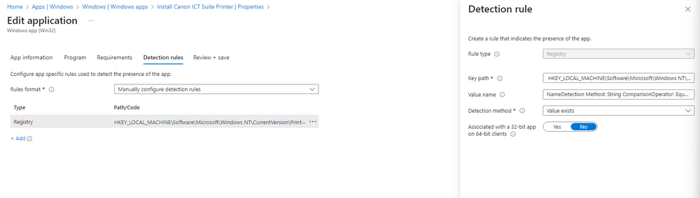

EssentialRug Posted July 11, 2024 Report Posted July 11, 2024 Hi, thanks, very useful. I am getting Invalid Detection Rule errors when I deploy to any station. I added Rules format as Manually Configure Detection Rules, path/code: Key = HKEY_LOCAL_MACHINE\Software\Microsoft\Windows NT\CurrentVersion\Print\Printers\ICTSuitePrinter Value Name = NameDetection Method: String ComparisonOperator: EqualsValue:ICTSuitePrinter Detection Method = Value Exists Associated with a 32-bit app on 64bit clients = No. Where have I gone wrong? Can you post a screenshot of your detection rules?
talksr Posted July 11, 2024 Report Posted July 11, 2024 Can you post a screenshot of your detection rules? Sure, no problem...
EssentialRug Posted July 11, 2024 Report Posted July 11, 2024 Sure, no problem... [ATTACH=CONFIG]71876[/ATTACH] So you just need to amend it so that it looks like the below. 1
talksr Posted July 11, 2024 Report Posted July 11, 2024 So you just need to amend it so that it looks like the below. [ATTACH=CONFIG]71877[/ATTACH] Thank you. I have just updated it. Will wait for it to refresh on the clients and I will let you know if it worked!
talksr Posted July 11, 2024 Report Posted July 11, 2024 Thank you. I have just updated it. Will wait for it to refresh on the clients and I will let you know if it worked! Doesn't seem to be going still. So this is the install command: powershell.exe -executionpolicy bypass -file .\Install-Printer.ps1 -PortName "IP_10.75.44.160" -PrinterIP "10.75.44.160" -PrinterName "ICTSuitePrinter" -DriverName "Canon Generic Plus PCL6" -INFFile "CNP60MA64.inf It is a Canon copier. The uninstall command is: powershell.exe -executionpolicy bypass -file .\Uninstall-Printer.ps1 -PrinterName "ICTSuitePrinter" This is how it is configured now:
EssentialRug Posted July 11, 2024 Report Posted July 11, 2024 Doesn't seem to be going still. So this is the install command: powershell.exe -executionpolicy bypass -file .\Install-Printer.ps1 -PortName "IP_10.75.44.160" -PrinterIP "10.75.44.160" -PrinterName "ICTSuitePrinter" -DriverName "Canon Generic Plus PCL6" -INFFile "CNP60MA64.inf It is a Canon copier. The uninstall command is: powershell.exe -executionpolicy bypass -file .\Uninstall-Printer.ps1 -PrinterName "ICTSuitePrinter" This is how it is configured now: [ATTACH=CONFIG]71879[/ATTACH] [ATTACH=CONFIG]71880[/ATTACH] Can you remove entirely and create a new one from scratch? I've just copied my install/uninstall commands and input your information in them. Maybe give that a go? Everything in your detection rules looks ok unless I'm missing something glaringly obvious. powershell.exe -executionpolicy bypass -file Install-Printer.ps1 -PortName "IP_10.75.44.160" -PrinterIP "10.75.44.160" -PrinterName "ICTSuitePrinter" -DriverName "Canon Generic Plus PCL6" -INFFile "CNP60MA64.INF" powershell.exe -executionpolicy bypass -file Uninstall-Printer.ps1 -PrinterName "ICTSuitePrinter" 1
talksr Posted July 11, 2024 Report Posted July 11, 2024 Can you remove entirely and create a new one from scratch? I've just copied my install/uninstall commands and input your information in them. Maybe give that a go? Everything in your detection rules looks ok unless I'm missing something glaringly obvious. powershell.exe -executionpolicy bypass -file Install-Printer.ps1 -PortName "IP_10.75.44.160" -PrinterIP "10.75.44.160" -PrinterName "ICTSuitePrinter" -DriverName "Canon Generic Plus PCL6" -INFFile "CNP60MA64.INF" powershell.exe -executionpolicy bypass -file Uninstall-Printer.ps1 -PrinterName "ICTSuitePrinter" Thanks, Did it again, this time, it is installing to devices in the deployed group with success but NOT the one I am testing on. I have a feeling this may be to do with the port number assigned in the client app. This bit = -PortName "IP_192.168.1.1" I am wondering if where I have manually added the printer before as a local Administrator, that port is already used so it is causing an issue when this client app goes on. Could I re-name the portname to something different such as "IP_192.168.1.1MDM"? EDIT: It has worked. Seems to be a lengthy time delay but it has gone through, I just had to remove and re-do as you advised. Thank you 👍🏻
