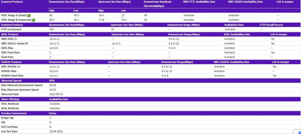

40 is perhaps me being a bit harsh, but it of course might vary day-to-day and certainly Wifi versus wired makes a difference. I work from hone 90% of the time so haven't checked regularly but I don't recall seeing over 50. Anyway, thanks for the link - here are the results which I know you will be able to better interpret than me.

So looks like your download if nearly the best you can get. I'd review the network internally but if internet is a requirement for the charity I would be looking to upgrade to something faster.
