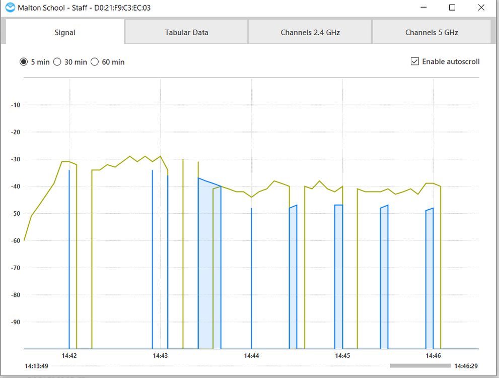

We have 1 U6-LR AP (the LR wasn't my preferred choice but stock issues its all that's available) per teaching space. The max client load per AP in a standard classroom is at 38, often in the mid 20s. Ive never seen an AP exceed 40 users. I've done all the usual stuff, manually scan area for best channels, adjusted power of APs to minimise bleed outside the room (they are almost all running on Low with the exception of AP in large communal area that are on med). All APs are ceiling mounted as close to the center of each room as possible. Below is a signal scan of what happens when the performance nose dives. (2.4 channel in green and 5ghz in blue.) The scanning device is in the dame room as the AP less than 3 meter from it, in open space.
Any ideas what could be causing signal to yo-yo like this? It's practically unusable during these periods, and can go on for 20/30mins at a time. It doesn't do it all the time, sometime performance is excellent. The feedback from staff across the site is its intermittent, with enough problems to result in thee digressing away from planning lesson on iPad. Queues are forming at the photocopier, we have seen this for years!
