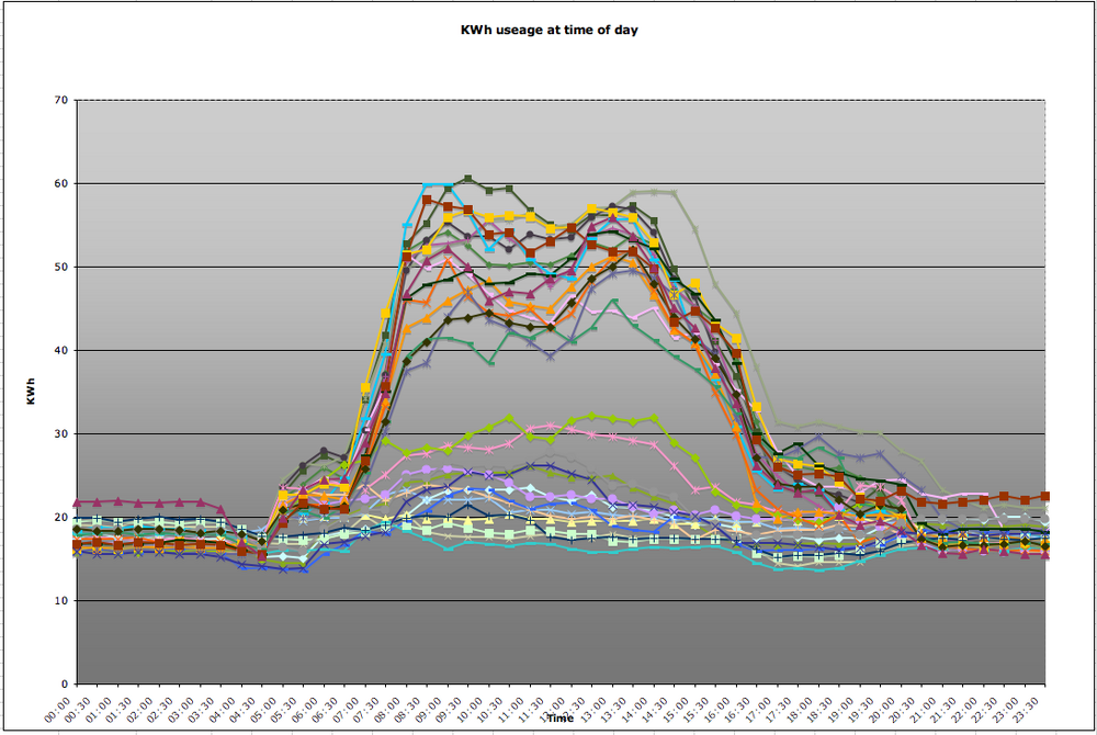

we moved to a new power provider, and now have access to our power history logs for every 30 minitue period every day. Graphs wouldn't work when i tried it today but was able to make my own in excel from the downloadable csv file.
interesting thing i found out is that our school consumes approx 800KWh on a day when not 1 single person is in the school and peaks at 1600KWh on a normal school day......
or £68 and £145ish a day
Im not 100% sure if this includes the swimming pool/sports facilities which could bump things up
anyone else have access to similar data? whats it like for your school?

well they were straight from the excel sheet, clicking on them highlights the row in excel (on a big 30inch screen this is all viewable on 1 page) so didn't bother putting the legend on sorry :p
