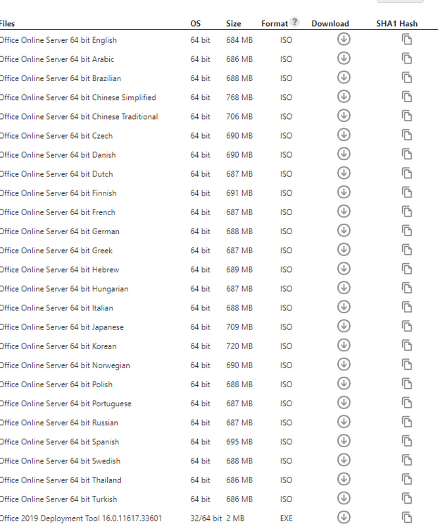

Steve21 Posted June 17, 2021 Posted June 17, 2021 Interesting... I've got a bog standard ISO of 2019 with setup.exe for individual no domain devices, just came from VLSC My bulk deployment is as you say... Interesting indeed... Do you still have access to download it? The only versions I've ever seen on VLSC are Office online servers, or the setup.exe standalone download. Never had access to a 2019 ISO on mine: Steve

Gongalong Posted June 17, 2021 Author Posted June 17, 2021 Do you still have access to download it? Ironically we're in the middle of renewing our licenses, and our reseller are late (as per usual) so the VLSC is currently in limbo while the renewal is processed. Although I was sure the 2019 installer wasn't there, and you had to use the ODT.
