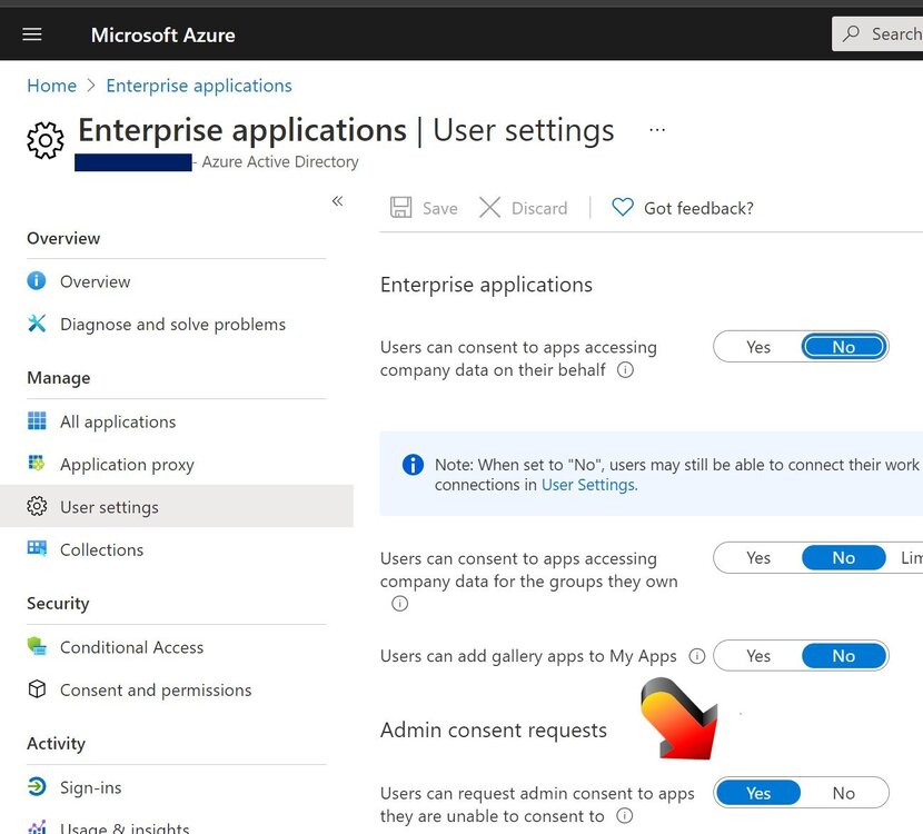

I've set Azure to notify me if someone requests to connect from a new platform and authorize in Azure as necessary. That gives me a list of all the 3rd party sites using the login info and we can disable or restrict if needed. Not that we ever has as it seems quite secure.

Any chance you could advise how you set this up and monitor new (and existing) requests?

Think its this setting
