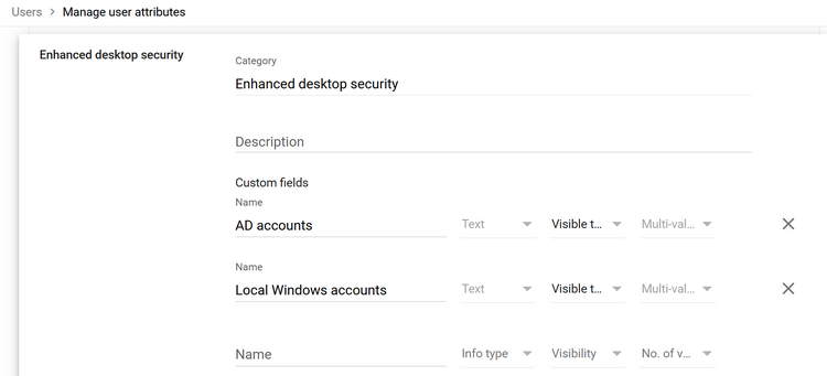

Have you added the custom attribute on the google side? If not, you can login - but the account is not linked to AD and things like Papercut won't work. The AD password is changed when you login with the Google account immediately - no delay. So if the attribute is set correctly on the Google side it should just work.
I did mean to ask about that too. I set it up with custom schemas in GCDS and found a guide that says adding userprincipalname is ok eg [email protected] rather than domain.local\user which your guide does. Any idea if there is a difference?
Does it look like this is the Google Admin console? Should show addomain\username under the custom attribute (which you must add on the Google side)

No, as my previous it would look like [email protected] as I read that you could use that but I do see that the official docs say wps\roger
The official docs do say that you can sync this field with GCDS and I managed that using the ad field userprincipalname. However, domain\user isn't held in active directory. So unless someone knows how to get that as an LDAP field I'll need to go back to one of the other API solutions.
Suppose best of both will be having gcds sync samaccountname to a field then have a bit of AppsScript running on a trigger to prepend the domain\
Yep needs to be domain\username in the custom field. I have one school who users GADS to populate the field - but you do need a custom field on AD - another just a powershell script to dump users to a csv and then sync to Drive, import to a Google Sheet and a bit of sheet scripting to populate the field from the Google Sheet.
Thanks, I've got something setup for getting the custom field populated ok now.

I enabled verbose logging on GCPW and the most useful error is "MakeUsernameForAccount: No valid sid mapping found.Fallback to create a new local user account". If I add a key for the users AD SID with their email address value then the link occurs e.g. HKLM\SOFTWARE\Google\GCPW\Users\S-1-5-21-2785799904-2391824654-440469764-13604\email = [email protected]
We use salamander to populate the 'o' attribute in AD then use GADS custom schema to populate the AD attribute on the Google side.
If you are having trouble with new user profiles it may be worth trying FQDN\username for your attribute rather than DOMAIN\username of not already.

Can someone post their Custom Schema setup from GCDS? I'm not sure I'm getting the correct field names. The sync seems to be adding the LDAP field as a seperate custom attribute based on the ldap attribute name. How do I point it to the "Enhanced desktop security > AD accounts" google attribute?
We point ours to the 'o' attribute in AD which is populated with our domain\username
GCDS - Custom Schema
Schema Name = Enhanced_desktop_security
Field Names / Google field = [AD_accounts]
LDAP field = o
Hope this helps.
