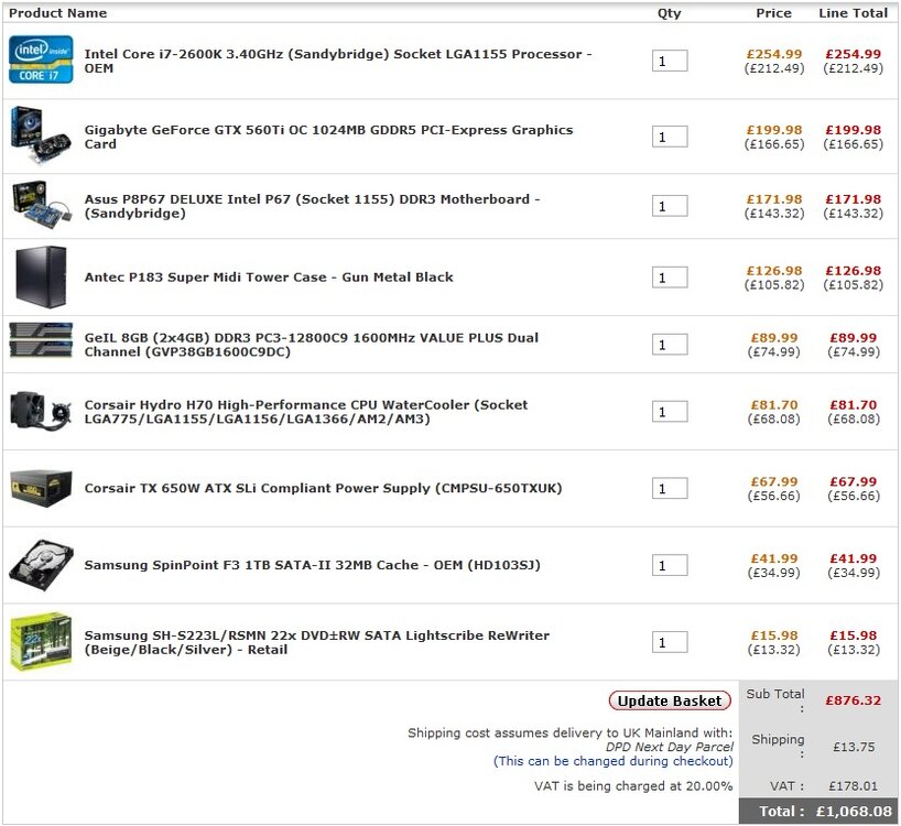

So, the last time I built a new PC was in January 2011 (See my "Spec me" thread from 10 years ago here!)
And here is the final setup I went with.
Had a couple of hard disks die, the GPU died and so did the PSU. I've now got a GTX 970, a modular Corsair PSU and an SSD, as well as doubling the RAM when my brother replaced his identical setup.
As I'm approaching 10 years, I think it's definitely time for an upgrade, especially as the system has become a bit more unstable in 10 years and is BSODing quite often!
I generally use the PC for work, running 2 x LG-27UK670 27" monitors. I'm also a casual gamer, my main games of choice are, FIFA, a range of 3rd person games (Hitman, GTA, Metal Gear Solid) and a few racers, Forza, Need for Speed etc
Here's a breakdown of my current setup from Speccy:
