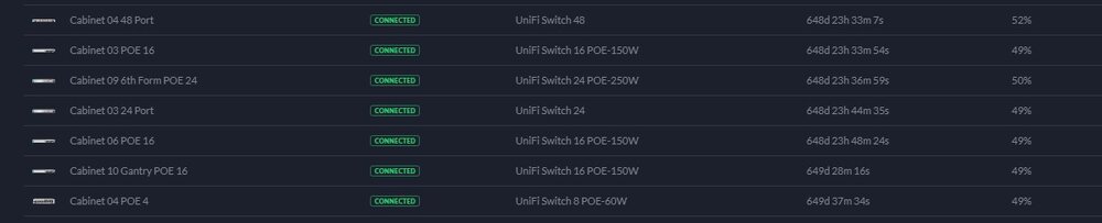

If anyone is worrying about unifi stability
They do have their quirks, I have weird VOIP phone issues now and again also some users have issues with connecting to wifi but I think that's just an IOS thing.
