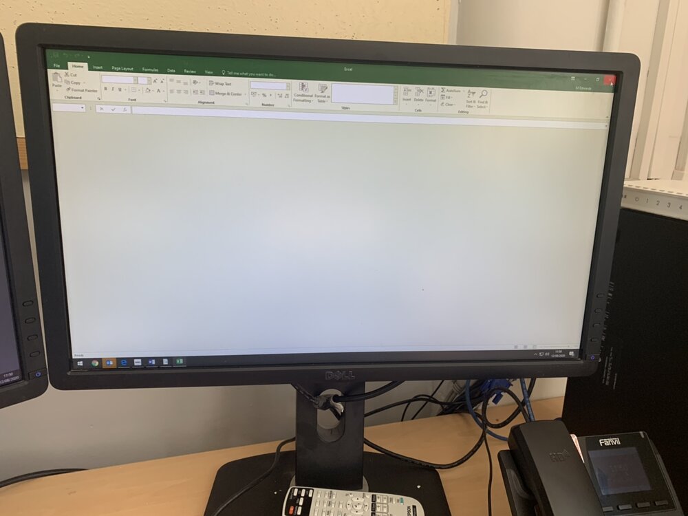

Sorry to resurrect this ancient thread but this issue has just reared its ugly head at one of my schools. When double clicking on an excel file, I just get the empty screen. I can open the file by going to File and browsing for it and it opens fine, just not be double clicking. I have tried the remedies online (that the OP also listed). This is Win 10 and Office 2016., logged in as an ordinary user and as a domain admin.

The latest I've observed this behaviour is with NetSupport's Classroom.Cloud. Contact their support and there's a workaround whereby you can apply a GPO to change the behaviour of the Classroom.cloud client. This applies after the device has been restarted.
