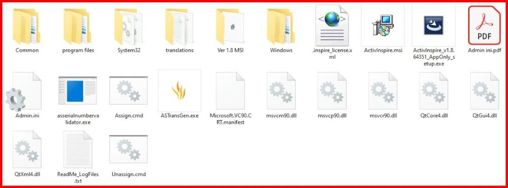

This is what my deployment folder on the SCCM server looks like:
The contents of the .inspire_licence.xml file:
School NameSchool Academy Trust Name20 Digit Promethean Serial Number
Sorry I can't be more help but I really can't remember anything more. However, I will keep looking to see if I can find what I have forgotten.

I've tried with ActivInspire_en_GB_windows.exe /S /v/qn and ActivInspire.msi* /qn /norestart, both with a .inspire_licence.xml file that I've filled out (I assume, all I actually have is the serial number because I've inherited the network) in the same directory and neither works, and both methods still ask for registration details at launch.
The network install option also does not provide an ASTransGen.exe file to create a .mst
* Generated via the Network Install option
