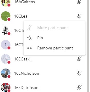

maxrebo Posted June 19, 2020 Author Posted June 19, 2020 Ok so I've made a bit of progress on this, changing the "Who can Present" setting to Only me stops them from muting each other but it hasn't removed the ability for them to remove other participants out of the meeting!. I've just been on the phone with MS about this and they suggested that the students shouldn't be Members but Guests??. Could anyone confirm how they have their pupils added in each Team? we currently have them as Members and staff as owners. Thanks
robyholmes Posted June 19, 2020 Posted June 19, 2020 Ok so I've made a bit of progress on this, changing the "Who can Present" setting to Only me stops them from muting each other but it hasn't removed the ability for them to remove other participants out of the meeting!. I've just been on the phone with MS about this and they suggested that the students shouldn't be Members but Guests??. Could anyone confirm how they have their pupils added in each Team? we currently have them as Members and staff as owners. Thanks I understood this to be the Meeting Roles bit rather than the Team membership itself. https://support.microsoft.com/en-us/office/roles-in-a-teams-meeting-c16fa7d0-1666-4dde-8686-0a0bfe16e019
maxrebo Posted June 19, 2020 Author Posted June 19, 2020 I understood this to be the Meeting Roles bit rather than the Team membership itself. https://support.microsoft.com/en-us/office/roles-in-a-teams-meeting-c16fa7d0-1666-4dde-8686-0a0bfe16e019 Yeah I've set this as default via Powershell but it still lets them kick people out as an option in "Show participants" and click on the three dots teams.pdf
