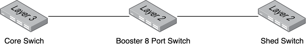

Hello,
We have a little bit of a mess I have inherited. We have a copper connection between our core switch and a switch inside a shed at the back of the building. This connection is over 100M so in the middle of this the previous IT team installed a switch to repeat the signal. I want to get rid of the repeater switch. The core switch is POE capable. Is there any device that can power via POE that I can put in the middle of the run to repeat the signal please? Has anyone on here used something like this please? I don’t want anything that needs its own power source.
I have found this but it seems to be in the US only - https://www.amazon.com/GPOE-Extender-802-3at-Gigabit-Ethernet-Extender/dp/B0757XQ32V
Thanks.

It’s a switch on the other end. (I attached a diagram on the original post). I can’t really lay cables without significant work involving digging up a lot of concrete!
