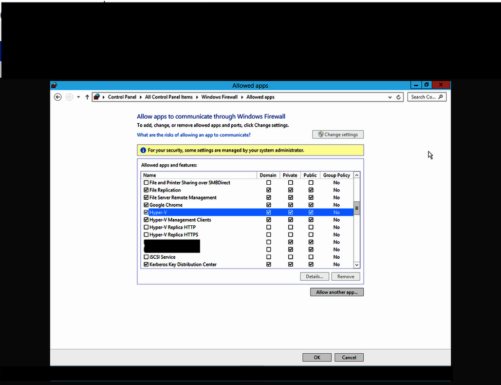

However, I noticed in the firewall settings of the server that now works as per screenshot, there is an app allowed for hyperv, however, this is not an app its a folder. This wasn't showing yesterday but today it is. To be honest, i'm not even sure how I got that in there as when you browse to the app through the firewall, it browses to a hyperv folder not a hyperv app, so it's not like I can select an app called hyperv, but I think this is helping the connection.
On the server where it now doesn't RDP in via VPN, this hyperv app or should I say folder isn't showing.

Have you rebooted the server?
Look in the Firewall Advanced view, inbound rules, anything in a HyperV group there? I have 7 items, and you can click Properties to see what they actually are.
Thanks for this.
I noticed that on this particular server there are only 3 rules, whereas on a working one there are 7 items as you also say above. I can't see how to add extra rules to a group called Hyperv. I can't even see where the rules are setup on either server. I assume they are done via Group Policy but can't even find them and have looked and looked through the various group policy settings.
