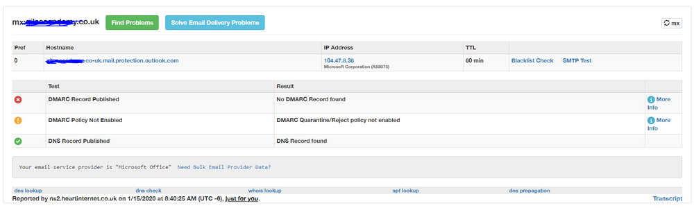

Can someone do me a favour, please?
Could you go to https://mxtoolbox.com/NetworkTools.aspx and perform a CNAME test against your school's domain - and post the result as a screenshot? Please omit your domain name if required.
I've just done a CNAME lookp and the test result comes back as 'DNS Record not found'.
Ours comes back also "DNS Record not found" but I think that is to be expected as cname maps name to another name ?
