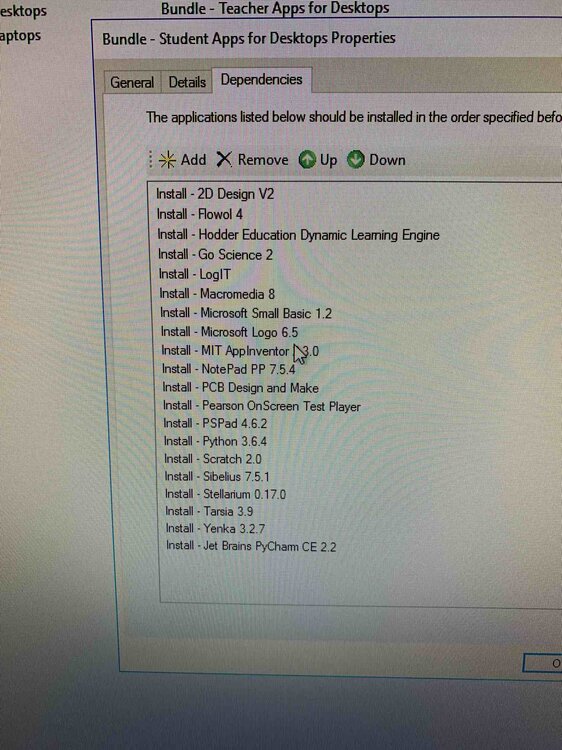

One of my curriculum apps is breaking things
I’m going to be working through each one individually but value anyone’s opinion on which the culprit is.

Found the software....
Drum roll 🥁
It was a piece of software called LogIT.
Not found why yet but evidently it causes issues with cs4 installer
