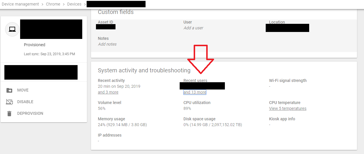

Are you looking below custom fields as within that heading or below that entire section?
It is within the system activity and troubleshooting section, first row second column titled recent users. Big red arrow.
If nothing is populated there I doubt gam will tell you anything.
[ATTACH=CONFIG]55076[/ATTACH]

I have the recent users section but its blank for every chromebook. I do have the "delete data on logoff" setting which I guess is the cause but seem to remember it made the login page a mess if you didnt do that. Going to grab my test Chromebook and do some testing.
Thanks
Seems things have changed and now I have removed the "erase user data on logoff" setting, reporting who last used the device works.
Thanks for all your help and suggestions.
To fix the logon screen mess go to device settings and find sign in screen.
Set it to Never show usernames and photos.
This will force everyone to type username / password every time, and retain profiles if you have changed the other setting.
