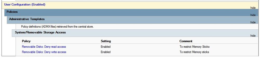

We have a USB ban in school via the following GPO
This allows us to still have our cameras work for photography and not worry about hardware ID's etc.
However the Microbit registers as a USB device so is blocked under the current settings; without going through every USB ID does anyone have a similar situation they are finding themselves in?
