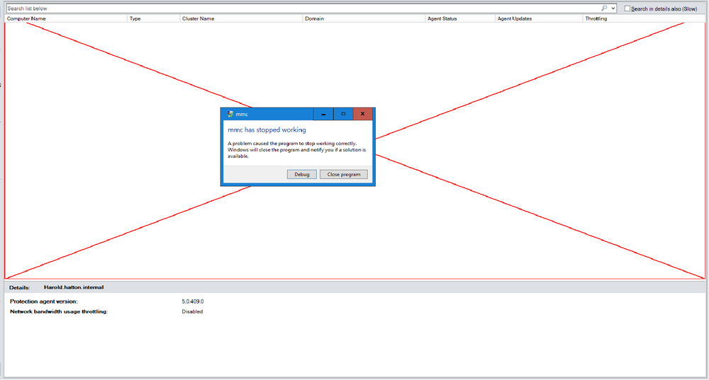

Upgrade failed as for some reason it didnt upgrade the DPM2016 database during the install! Didnt roll back or anything so when I try and open the DPM console it doesnt open up DPM! The DPM server wont start, it just stops straight away. Event viewer says that the DPM service wont start as the database version isnt compatible with DPM2019, thus proving that the DPM database did not get upgraded!
:( I've got loads of backups but cant access them or create any new ones! :(

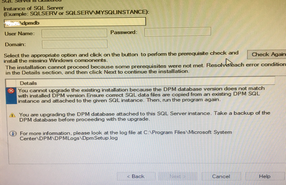

UPDATE: I've got upgrading SQL to a version supported by both DPM 2016 and DPM 2019 down to a T but I have a problem with the upgrade to DPM 2019 not working...
When I try and upgrade DPM 2016 to DPM 2019 it fails the prerequisites as it says that the version number of the DPMDB database withing SQL (not to be confused with the SQL version) does not match the version of the currently installed version of DPM.
If I take a look at the DPMDB version number within SQL I get 5.0.158.0 (which is the RTM version of 2016). When I go in to DPM 2016 the version number that is on is 5.0.409.0 which is the Update Rollup 7 version which was installed via Windows Updates.
So it seems that when the Update Rollup 7 was installed it either: 1) hasn't upgraded the version of the DPMDB database. 2) it has upgraded it but not changed the version number or 3) there are in fact no upgrades/changes to make so it didnt bother to change the database number within the database in SQL!
If it's the last option (that Update Rollup 7 didn't need to upgrade/change the database so it didn't bother to change the database number within the database in SQL) then from Microsofts' own website they provide an SQL script to simply enable you to manually change the database number so you can continue with the upgrade - I'm just concerned in case it's not the third option but one of the other two and by simply changing the database number manually to trick DPM in to upgrading will cause the integrity of the data to not be right?

@Fazza Not sure what to suggest. I just checked out DB version number and its definitely updated now within SSMS (10.19.58.0). Not sure what it was pre-update though.
Uninstall / re-install UR7? Take a backup of the DB of course before you do anything but surely the data itself would still be good if you messed anything up. Just relink and rescan source backup data....?
