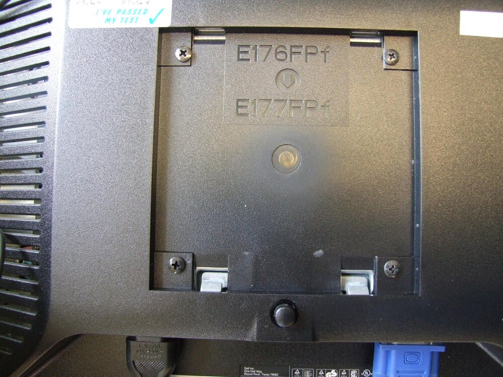

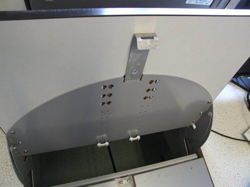

Can anyone help me find the right sort of mount that i would need to connect the monitor to the desk thing in the two attached pics?

Monitor will be one of the standard VESA mount sizes, measure it with a ruler, looks like 10cm.
Looks like a recess behind the where the six pairs of holes are, might be worth taking the desktop off to see if the holes in the back of the monitor line up. Might be a straight bolt-on job (placing the top of the monitor under the hook) in which case you don't need to buy anything other than screws that fit...
The monitor includes the screws already - they are the 4 screwed in in the corners of the recess on the monitor.
The screws on it are too short.
Seems a bit of an odd way to mount though, as these desks flip up and down, so surely with the monitor just 'hooking' on it'd fall off easyily?
