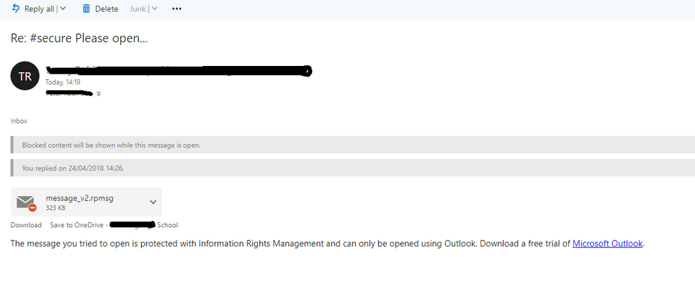

Hi - i've just setup office 365 mail encryption - all works fine sending out using #secure in the subject line and creating a rule to use the 'encrypt' template if the sender is inside the organisation and the recipient is outside the organisation. Recipients are able to open the email and read it - however when they reply i get an email that says it is encrypted with a message_v2.rpmsg attachment- i try to open this in OWA or Outlook 2016 - it won't allow me. I've verified my IRM Config in Powershell ( below )
the wierd thing is the reply is not encrypted as the user in question doesnt have it setup - they are just replying to my email yet it says i have received and protected message - below is the email i receive and the message i get when i try to open it. I thought it maybe that my rule was encrypting it as the cam e back in as the subject still had the #secure tag. I eliminated that by specifying in the rule that the sender is inside the organisation and the recipient is outside. i f tehy reply to the email without opening the encrypted message it comes through ok , but if they reply to the encrypted message - which is what most people will do it adds the attachment. Any clues anyone please ?

I'm having a similar problem. I started looking at the Azure rights thing yesterday. I managed to activate it and set up a basic mail rule to encrypt anything going outside the organisation with "Encrypt:" in the subject heading.
Messages seem to go out fine. To a Hotmail/Outlook account, the message just opens and there is a message in the heading saying that the email is encrypted. With gmail they can open it by requesting a one time passcode. No problems here, but its the replies I'm struggling with. The replies all come through with that message_v2.rpmsg attachment and I can't open the reply no matter what. I click the link to read the message which opens my browser and says I need to install Outlook :-/ That's what I'm using!!!!

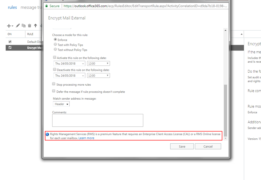

Thank you for you help. I have now setup, but at the bottom of the rule it says "Rights Management Services (RMS) is a premium feature that requires an Enterprise Client Access License (CAL) or a RMS Online license for each user mailbox. Learn more"
Untitled.png ????
Yep, don't worry about that. I get the same thing - I think they just haven't updated their pages yet. If you go into the main Office Admin centre page, search for one of your users (or yourself). Have at look at your assigned license and expand it to see all the sections you have. About half way down there should be one called Azure Rights Management - it appeared on there a while ago, automatically switched on.
