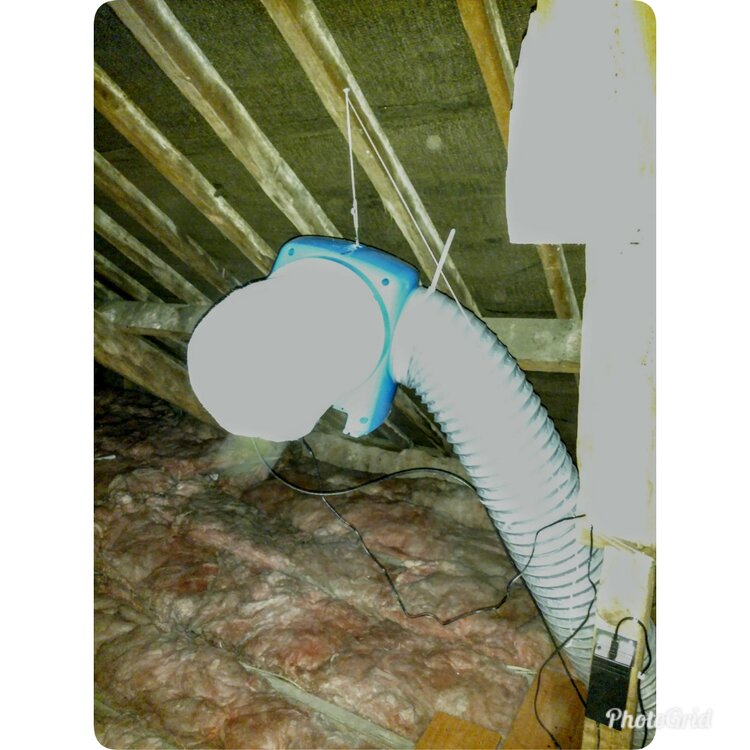

Me and my dad installed it in 2018 i think. My dad got one the same time. Apart from the temperature shut off its run 24/7 since then. I do have the remote for it but forgot to pair it when we installed it and its to high to reach without a ladder.

No, the heater is on the output not the input. Input is via two large fabric filters, the heater goes via a collar on the output before the ducting.

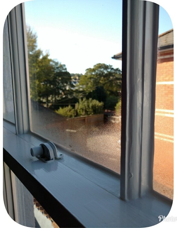

Well, I finally pulled the trigger on this one about a month ago (just the basic one, loft controls/no heater)... and it works!
Even on the couple of minus degree nights we've had recently, there's only been a couple of mm or so condensation on the main bedroom window, which previously would have been full window and dripping. No condensation on any other windows, which would normally be in a similar state.
