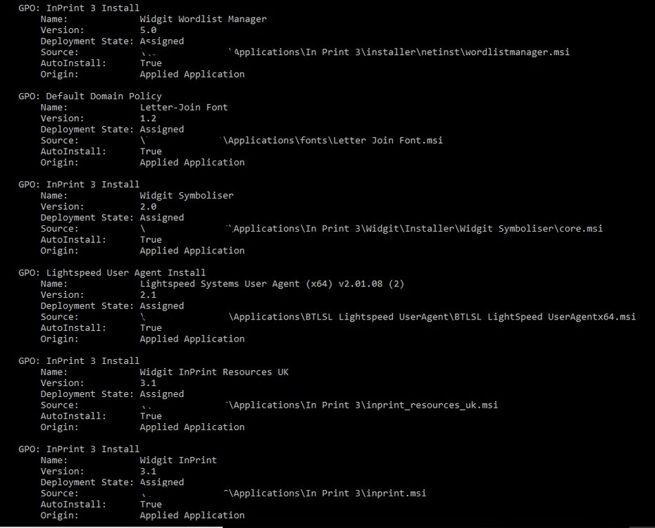

Try to manually install the MSI's, /passive will do it for you. If it fails with a manual install, then call Widgit.
InPrint3 will fail to install if the licenses have run out on Widgits server side, may need them to reset the count. I had that problem after rebuild a load of machines.

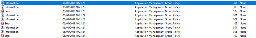

Has anyone managed to deploy core.msi through SCCM? Ive done the admin install of the original core.msi so it creates another with all the settings but when i deploy it out through sccm it just fails with the message Past Due - will be retried.
Installing the core.msi manual through a cmd prompt works fine.
Sounds like the SCCM date required installed by thing is wrong
