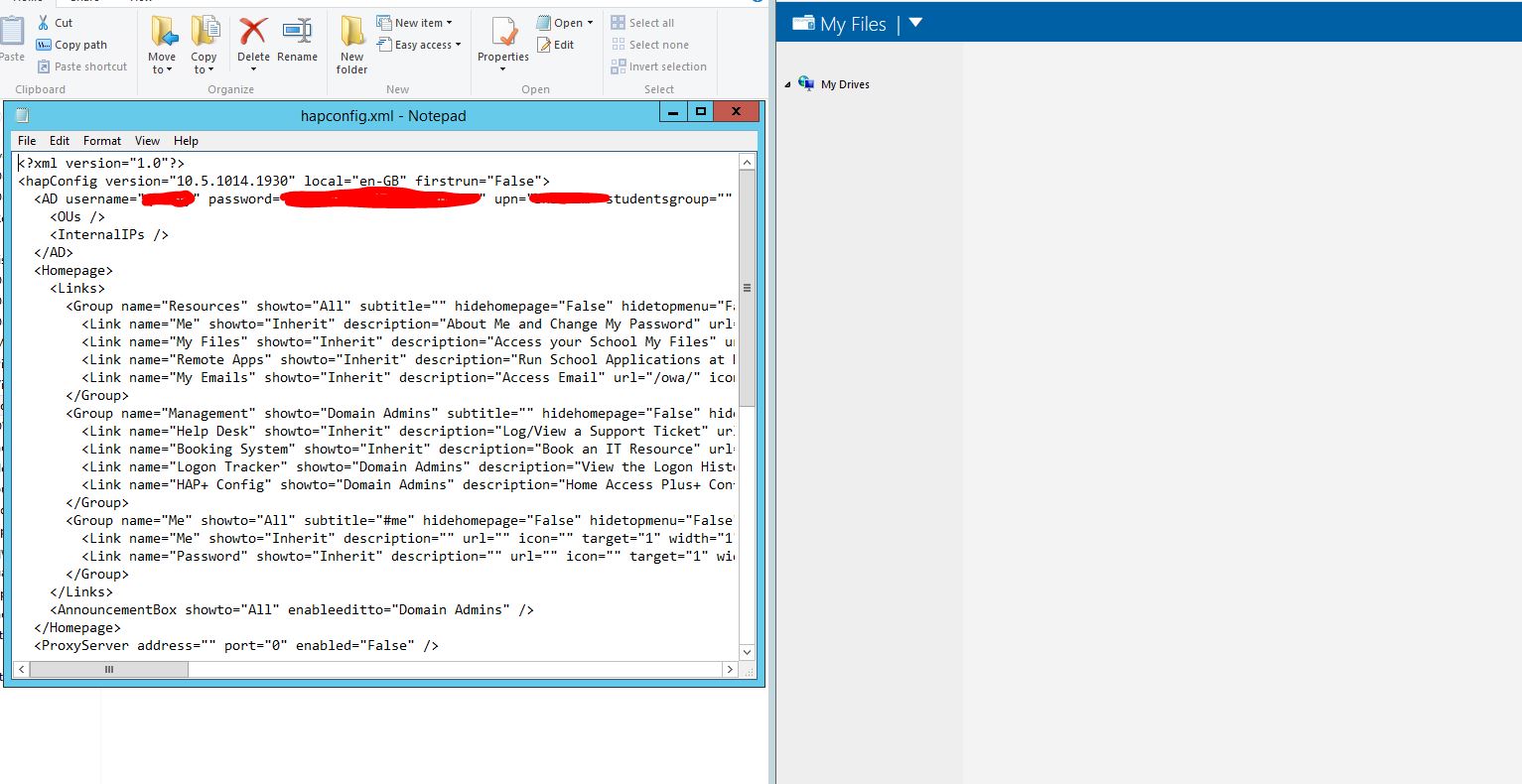

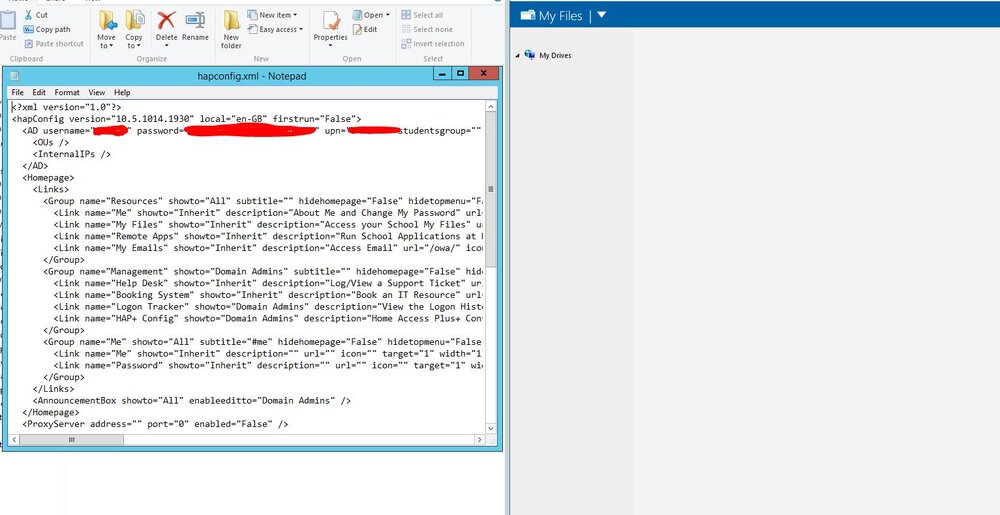

I've done that from 10.0 to 10.5 = doesn't work
From 10.6 to 10.5 - not tried removing files, which ones do i need to remove? Is it the ones the come with 10.6?
Delete the files? Which files do i delete? The ones that are sat in 10.0 which will be upgraded to 10.5?
So i've tried downloading 10.0 as a clean install. Looked at the files 10.5 will over write and removed them from the 10.0 release folder.
Copied the 10.5 files into the relevant places and run setup again. Setup completes but i get MyFiles in the top left but nothing else. I don't see the MANAGEMENT tab either on the dashboard of HAP - not edited webconfig to deny specific users either!

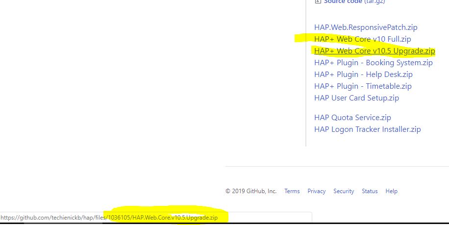

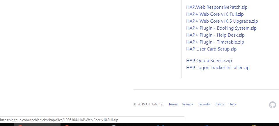

I've looked at that but that includes 10.0 and the 10.5 upgrade files, not the 10.5 full core files.

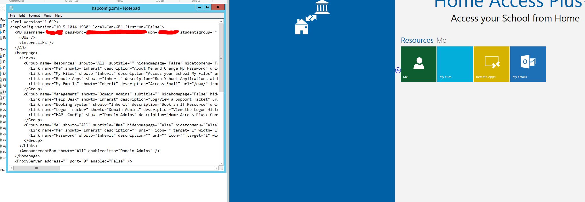

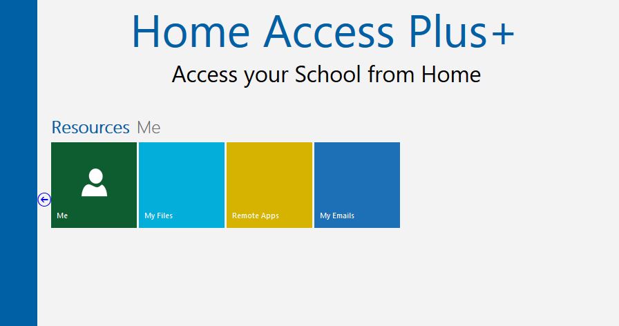

Just downloaded HAP+ Web Core v10 Full.zip from that very page and installed and i get the following:
As you can see no management options or no My Files even though browsing https://{servername}/hap/setup.aspx shows a mapped home drive.

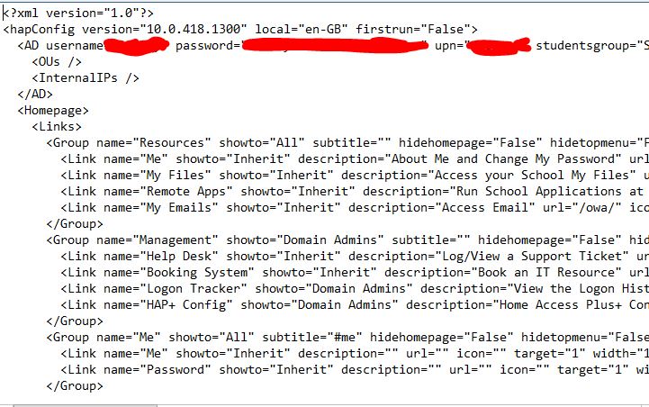

Looking at the hapconfig.xml this clearly isn't 10.5 as the hapconfig version in the xml shows 10.0.418.1300

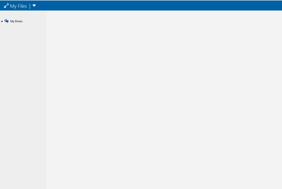

Am i supposed to download 10.0 from the link above and then add 10.5 files? If so, that doesn't work either as shown here:
What do you get when you go to /hap/api/ad/roles/$username. If you don't get anything you may need to try upgrading the hap.ad.dll from the v10.6 pack
