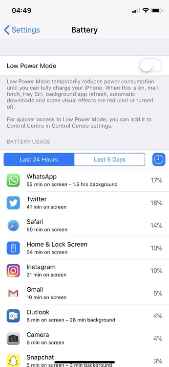

With WhatsApp enabled:

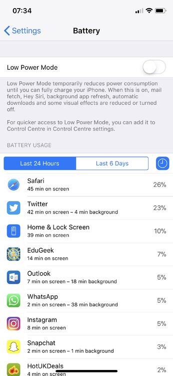

With WhatsApp disabled (No notifications, not used for over 24 hours)
What still isn't explained is what us causing drain when the phone isn't being used. None of the apps are being used between 1am and 7am. So what is using 15-20% of battery?
