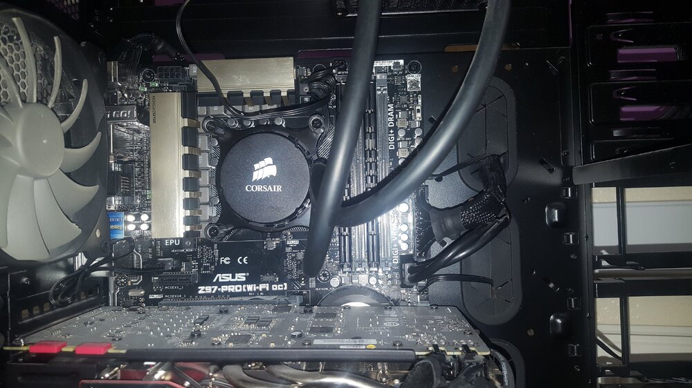

Basically I live on a pretty large hill out in the country and on Monday night when the storm hit I fancied playing a bit of Mafia III but as soon as I turned my rig on it instantly shut itself down, it then keeps doing it like it's in a boot loop. It was working fine on Sunday night and I've never before had a problem with it for 3 years of using it. So last night I took all the components out and just tried powering it on with only the motherboard. I have figured out that regardless of whether or not the CPU is in the socket as soon as I connect the CPU's 8-Pin power to the motherboard it will turn itself off but if I just power the motherboard up with the 24-Pin ATX power and no CPU power plugged in it stays on.
It won't POST, it doesn't beep or give me an error code of any sort. I'm unsure as to whether it's the PSU not giving enough power out, although it will run the motherboard and will run Hard Drives and everything else just fine. Or do you think it would be the motherboard, I can't see any obvious damage but I'm unsure, I've checked the CPU and CPU socket too but can't see anything wrong with the pins.

If you have tried with another PSU use a multimeter to check if you have a short between the 12v and GND on the motherboard on the 12v connector. Sounds like a short on the CPU VRM.
The 12v ATX connector is on a separate rail in the PSU and is separate on the motherboard. It's why it partially works with the 24 pin connector plugged in.

Have you tried with the motherboard out of the case and on a non-conductive surface? Something might be touching the back of the board (or the board might be touching something) and causing it to short (I had this with an fan header card once).

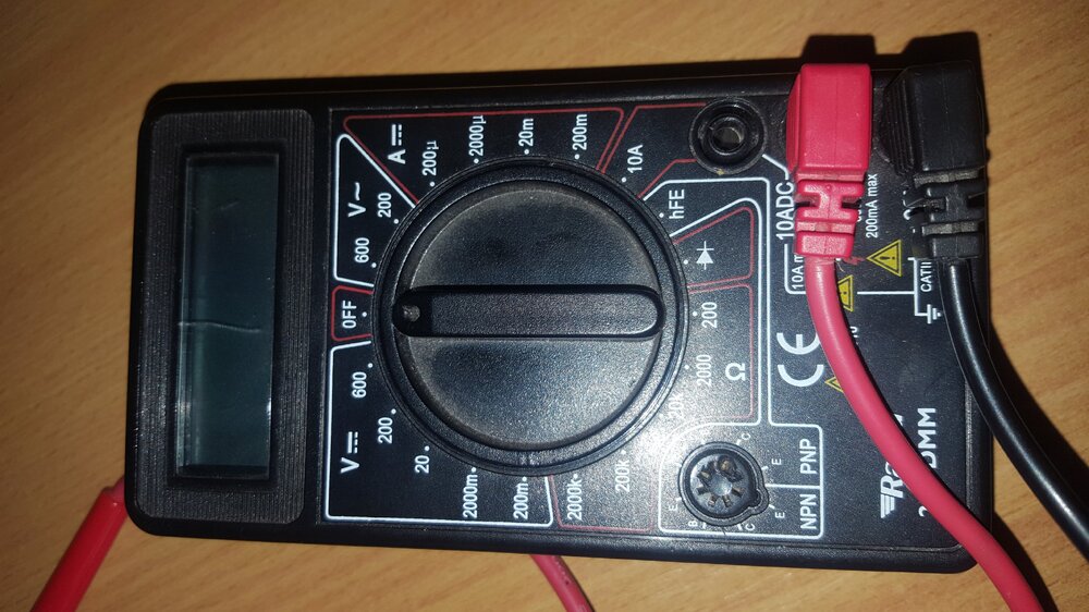

Haven't got a multimeter unfortunately :( So can't test that way! If I do some how find one how would I go about testing it? Do I just touch the pins inside the block connector on the 12v power?

Yes, there are a couple of ways but the easiest is put the multimeter in diode mode, then the red probe on one of the ground pins in the 12vATX connector on the motherboard and the black probe on the 12v pin.
I expect it to read near 0v indicating a short, a working board will show around 0.5V on the meter.

Ok so I've been able to source one but I don't have a clue on how to use this thing or what to turn the dial to?Do you happen to have any ideas?
Turn the dial to the diode symbol. With the display at the top it's the symbol at 5 o'clock between 200ohms and hFE.
Red lead on the ground of the socket, black lead on the 12v
You could look at the power supply EPS connector, yellow is 12v black is ground, but you have all black cabling.
You could Google EPS 12v pinout.
Or I can tell you top row (closest to the latch mechanism) is 12v , bottom is ground :)
I should add that when you are testing, it's just the naked motherboard on a bench (not in the case) and no power needs applying.
