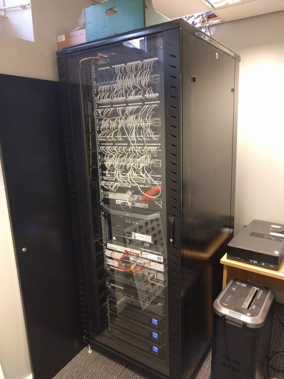

ive got some good and some awful depends how much theyve been altered from the first install and how much of that was planned rather than o damn we need a new switch for x reason etc.
Ideally now i do patch panel - brush plate - 48 port switch - brush plate - patch panel (repeat as needed)
this is the aim but its not always possible as schools often wont spring for new cables so you end up with cables that are far too long for the distance they cover
