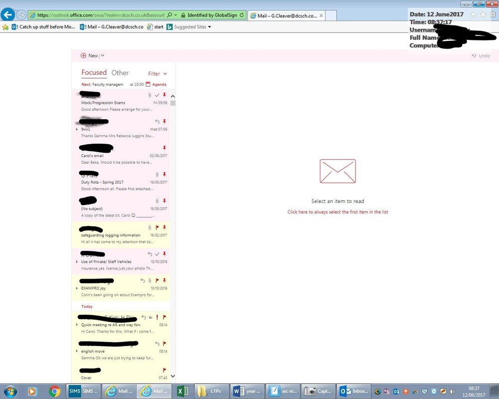

Some of our users are seeing the attached when they open webmail with Internet Explorer. There is no consistency - a user can get the issue on one machine, and not another, but other users on the original machine see no issues. We've cleared profiles and cleared IE cache, but no change. Chrome consistently works.
Any ideas?

I can't find anything obvious with Developer tools, but our issues started at the same time as yours. The strange thing is that two users in the same OU, with the same filtering can log onto the same machine and only one have the issue. However, it is consistently that user.
I've had the same issue last week, only affects IE, Chrome is fine. Nothing shows in the web filter.
The issue for us was the SMARTInk service running in the background. I think it somehow creates an overlay which interferes with how Outlook loads in IE. You can turn off SMARTInk so the toolbar doesn't appear but that won't stop this happening, the SMARTInk process needed to be stopped for things to work normally. I lost an entire day trying to figure this one out. Not sure if you are using SMART boards or not, or how you have user settings configured in your environment but for us this was the fix.

I added the following to a teacher workstation GPO:
Action Delete
Hive HKEY_LOCAL_MACHINE
Key Path SOFTWARE\WOW6432Node\Microsoft\Windows\CurrentVersion\Run
Value SMART Ink
Before getting this far I replicated the non-load situation then killed:
SMARTInk.exe
SMARTInkPrivilegedAccess.exe
SMARTInk-SBSDKProxy.exe
Then refreshed the page and it would load consistently each time.
Hope that helps some of you.
