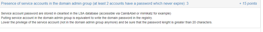

ADMaster Posted June 29, 2017 Posted June 29, 2017 There is a GPO that will allow users to install device drivers of the types you choose. https://technet.microsoft.com/en-us/library/cc725772(v=ws.11).aspx This doesn't always work and they end up bringing in the CD for me to install. I am working on setting up different admin accounts too and figuring out the best way to elevate. I have powershell scripts the create / disable users every day, I guess create a job specific account? I read service accounts are stored in plain text?? What permissions do I need to give my sccm / vmm service accounts? Anyone use PDQ inventory, its my go to tool. I launch remote support, pull event logs, launch client center etc. How much of this will break if I'm a standard user?
TwistedHelixis Posted June 29, 2017 Author Posted June 29, 2017 I read service accounts are stored in plain text?? Great - our LA setup some service accounts using domain admin groups - I just give up
